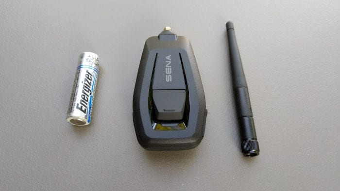

SENA +Mesh Overview
+Mesh shown next to AA battery module for scale
OK, where to start… this could be complicated – not.
With the +Mesh held so the SENA logo faces you, the Multi-Function Button, hereafter identified as the MFB resides below the logo with the Status LED immediately below the MFB.
The micro-USB port for DC charging and data connectivity is found on the lower right edge under the shaped silicone flap… which, of course, is oriented awkwardly and gets in the way of the connecting cable, again… still.
And outside of the Reset Button, accessed through a small hole on the back of the device, this is it for the tour…

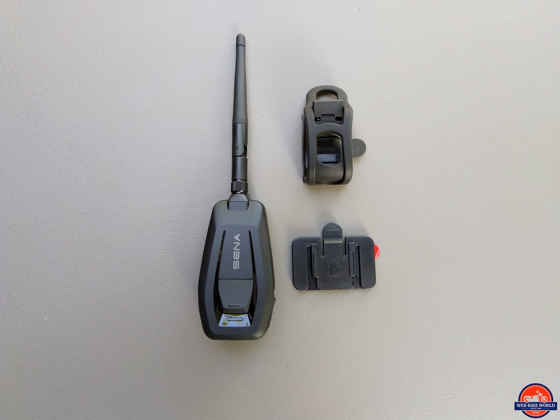

The +Mesh kit comprises:
- Main unit or module
- MESH intercom antenna (type xxx threaded)
- Handlebar mounting kit (bracket and loop)
- Mounting cradle (hard plastic/flat back, adhesive mounting)
- Micro-USB power and data cable, and
- Fold-out Quick Start Guide (pocket tuck-away sized)

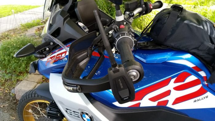

Temporary mountings that allow portability and removal for safekeeping are likely to be the norm with the +Mesh and this is reflected in the two provided mounting options.
One is a rounded plate with a silicone/rubber strap like the pieces used in the original SR10 and SM10 adapters. They are good for handlebars, lower mirror stalks or something related in size and shape – just make sure it is secure.
The second option could be more permanent in nature – at least for the bracket. This piece is a flat molding with an adhesive backing. The +Mesh module slides onto the front slide-n-click rail and is quite secure.
What needs remembering here is that for optimal use, the +Mesh antenna needs positioning for a clear or best line of sight use. Left or right mirror placement works, but may not be optimal.
+Mesh in an accessible spot that is also vulnerable to impacts

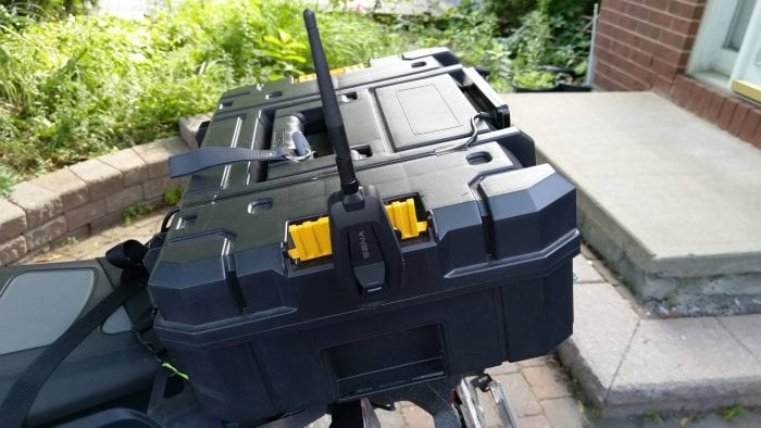

Although the +Mesh is pretty much a turn on, pair and use system, it isn’t totally set-n-forget, especially if direct access is needed to the MFB to start/stop participation in a mesh group or whatever. Safe access is always a key factor here.
One rider suggested that the +Mesh could be stuck to the left side of the aluminum top box using the adhesive plate with the rider reaching back as needed to access the control… uh, not for me.
But, the +Mesh is very light and could (considering weight, profile, and perhaps in the absence of a passenger) be affixed to the side or back of the helmet without too much risk. The module is removed from the flat bracket in a second or two.
