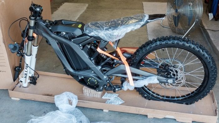

    The Arrival​
    Mine arrived two painful months later via FedEx Freight on June 13, 2018, and boy was I stoked! I felt just like a 12-year-old boy seeing his first Playboy Magazine. Well, maybe not quite that excited…
    But after watching Jackson do a teardown of the bike I opted to not fly down to see the bike before I purchased it. He seemed sincere and honest in the video and besides, what I witnessed in the video was impressive.
    Mind you I have never purchased something this expensive sight unseen! I’d been burned by prior crowdfunding campaigns, but this was different. It is NOT crowdfunding; it’s a real bike from an actual brick and mortar company.
    Assembly​
    Assembling the bike was very straightforward and there was an excellent YouTube video about how to go about doing so. I was very impressed by the build quality. It was just as Jackson had described in his YouTube video.
    My personal assessment of the build quality after having worked on Yamaha, Bultaco, Penton (now KTM), Maico, Kawasaki, Suzuki, and Honda motorcycles, is the Sur Ron’s build quality approaches that of Honda. Captured fasteners instead of loose nuts, precise alignment of fastening holes, excellent welding; basically high-quality engineering and manufacturing.
    I was very intrigued by the rear shock linkage. Rather than just a direct link between the swingarm and shock, Sur Ron had designed a progressive linkage system which is much more in line with current motorcycle technology. It made me very anxious to test it out once assembled.
    After inspecting all of the bolts I surmise that in China the Sur Ron Corporation must have hired several two thousand pound gorillas to torque down the fasteners! Seriously all of the fasteners are way overtightened. It’s great they’ve used blue Loctite on the fasteners, but with the amount of torque put on them…. why?

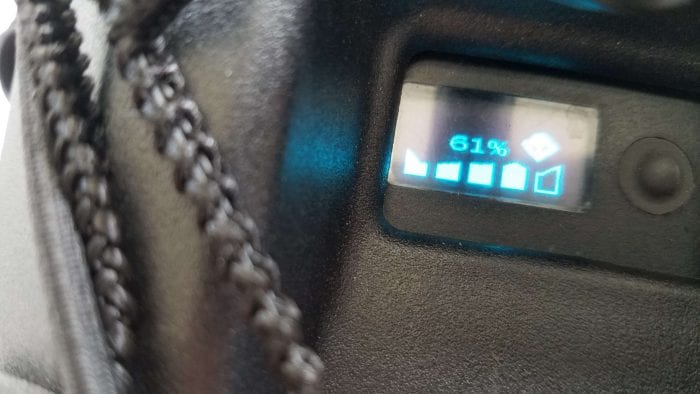

    The bike’s BMS (Battery Management System) has a safety feature. If you are riding in Sport mode and your battery level falls below a certain percentage, the BMS automatically switches you to EP mode.
    I say a ‘certain percentage’ because I’ve had my bike go into that mode anywhere between 13% to 21% as indicated on my battery’s charge indicator. It just meant that I had to ride back to my starting point in EP mode instead of Sport mode. No big deal for me.
    This is the battery indicator on the battery itself, not on the speedometer panel. My understanding is the newer models automatically illuminate this panel whenever the ignition is turned on.
    Mine does not, you must press the little button to the right to view the battery indicator. I’m not certain how accurate this gauge actually is in measuring the state of charge remaining. Just FYI.
    Although this has never happened to me if the battery gets so low that when you place it on your charger and it does not take a charge, there is a procedure to ‘jump start’ charging your dead battery pack. That has been covered in this YouTube video shown below.
    And from almost dead to a full charge has taken me just a tad under 3 hours to get my battery pack up to 100%

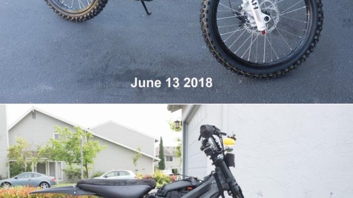

    Performance Modifications​
    One of the pleasures in owning the Sur Ron is its ability to be modified. Unlike a bicycle which for me is too simple mechanically or a regular motorcycle which at this point in my life is too much of a hassle, the Sur Ron is just right. And this would be a good time to say that the Sur Ron Light Bee occupies a space that in my mind that did not previously exist. Let me explain.
    When Apple introduced the iPad many folks tried to pigeon hole it as a phone and then as a laptop. Because it fell right in between those two devices, people just didn’t know what to do.
    In my mind, the Sur Ron is currently in the exact same situation. Not a bicycle and not a motorcycle. People are trying to see how it compares to a KTM-xxx or a Honda-xxx. The reality is it’s neither. It has created a space that’s new, just like the iPad created the ‘tablet’ space.
    I’ve modified my bike because of what and where I ride most often. I’m spoiled having ridden and raced on excellent motorcycle suspension and although my racing days are long over, that’s what I wanted for this bike too.
    My modifications in my own order of importance:
    Performance mods
    1. X controller with Regen
    2. Forks/Headset – Manitou Dorado Pros
    3. Cane Creek headset purchased from Luna
    4. Ohlins TTX22 Rear shock
    5. 21” Front wheel custom laced
    6. 225mm floating front rotor (OEM is 203mm)

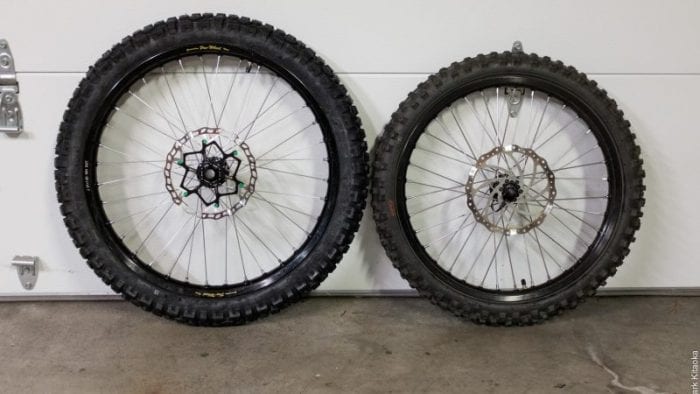

    From 19 to 21​
    In terms of hill-climbing ability, this little bike reminds me of the Little Engine that could! It just keeps climbing and climbing and climbing! The only limitation to its climbing ability is traction at the rear wheel.
    Because the OEM tires are 70/100 19” they are thinner than off-road motorcycle tires, but then again this is NOT a normal motorcycle. The rear tire wore out rather quickly, but the front remained fine.
    Because I ride in such a wide variety of terrain I opted to switch to a dual-sport tire. One that is good on all the surfaces I normally encounter. If I was ONLY riding in deep sand or mud, I’d have opted for knobby only tires. Instead, I switched to Shinko 244’s and have been very happy with their performance.
    I also opted to have a custom 21” front wheel built for me. Why? Well because the Sur Ron’s parts are primarily mountain bike units the 19” front rim had limited tire choices. A 21” front rim is the defacto size for off-road motorcycles, so the tire selection is endless.
    Plus I felt the handling would improve for what/how I ride over a 19” rim. When I presented my thoughts to others on the FB group, they all said: “Oh, that will be too heavy.” Yet when I asked all of them “What handling issues did you find when you rode a 21er on the bike?” SILENCE.
    Not any of them had actually ridden a Sur Ron with a 21” front rim/tire. It reminded me of forums where so many people like to pretend they know, yet don’t actually know. So for me, I will simply say that the change is wonderful for what/how I ride.
    The front end is more planted in turns, especially those that are off-camber; rutted fast downhills are much more manageable with the 21er. I love it.
    Custom moto 21″ wheel on the left – OEM 19″ on the right

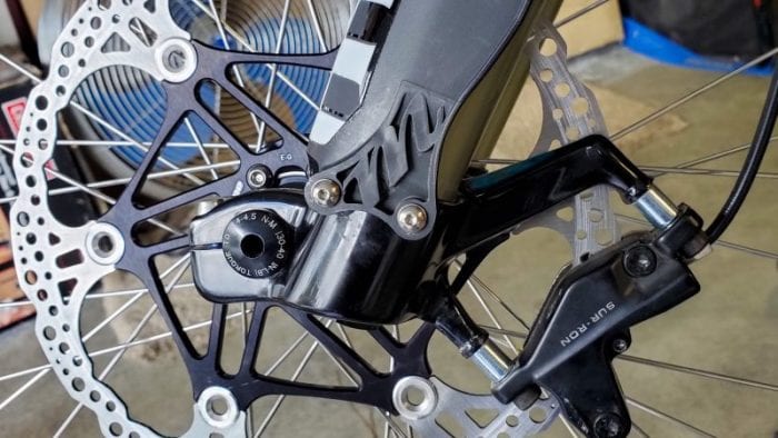

    Brakes​
    Some people on a private Facebook Group complained about the brakes on the bike. The complaints were about the brakes feeling ‘spongy’ or the lever almost reaching the handlebar grip during stops.
    Having come from a racing background I know the value of properly bled brakes, bedding pads in properly and so forth. I did both of those things to my bike before I started riding. I did a bleed of the brakes, which use mineral oil just like most mountain bikes because they are mountain bike brakes.
    I also bedded my pads in properly. If brakes are experiencing a spongy feeling or the lever is almost going to the grip before stopping, it’s an air in the brake line issue.
    To date, I have the OEM brakes and am very happy with their performance. They’re four-piston binders which work very well, have great modulation and stop the bike securely. I have changed the brake pads to an organic compound which does not last as long, but I prefer the feel and modulation of organic over semi-metallic or full metallic.
    It’s just a personal preference. I believe many folks feel that if brakes bite hard at the beginning, they feel the brakes are “powerful.” I too like power, but without subtle modulation, it’s not my personal preference.
    (Above) OEM Calipers using a 12.62mm spacer to adjust for the Hope 225mm floating rotor which replaced the OEM 203mm solid rotor.
    I prefer a larger floating rotor for more power and modulation.

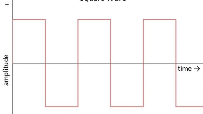

    USA Gen1 X Controller​
    About six months into ownership Luna was offering a limited number of X controllers. They were of the sine wave rather than the controller that came on my bike – the square wave type. And the X controller offered regenerative power and braking too!
    To explain, imagine a sine wave like a nice curved chart. The power ramps up to a smooth curve. A square wave has a sharp edge in terms of acceleration.
    Sine Wave & Square Wave
    I happened to be one of the lucky 50 who got the X controller with full regenerative power and braking. The smoothness of the throttle is very different than the non-X controller. It is as smooth as a well-tuned ICE throttle and the ‘engine braking’ (regen) is like third gear deceleration on a four-stroke bike.
    In a non-X controller bike, there is a definite hit when you engage the throttle. It is not smooth and letting off the throttle makes the bike coast like a bicycle, no deceleration unless you’re braking.
    I’m sorry to say that all X controllers in the US, EU, AU, and others with X controllers did not offer regen in the controller. The smoothness is there, just no regen. I feel damn lucky and happy to have one of the Unicorn X controllers! I hope Sur Ron brings them back for all future Xers too.
    My friend Matt who is one of the admins on the private Facebook Group created an excellent video comparing and testing the X and Standard controllers (shown below). Not only does it illustrate the performance differences, but the regenerative power put back into the pack.
    Update as of June 2019, my understanding is Sur Ron did enable regen on new X controllers, but to what degree I’m not certain.

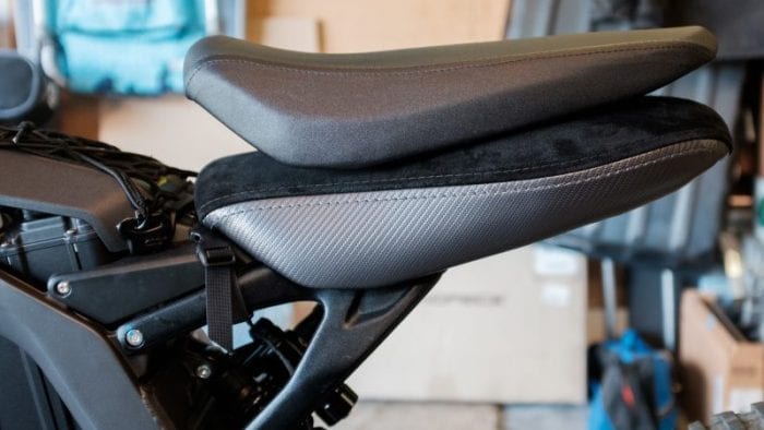

    Seat​
    After about a month I noticed that my ass was killing me after only 25 minutes of riding! The OEM seat is only 5.5 inches across at its widest point. And my butt resides in the back portion of the seat where the padding is much thinner than in the middle. It’s not a big bike and I’m not a big guy at 5-8 170 pounds with a 31” inseam.
    So I found a craftsman who makes custom dual sport seats, James Renazco Racing in Santa Rosa, CA. I wrote to James, sent him my measurements, weight and my seat pan. He called to discuss fabric options and when I got my new seat I was in heaven.
    [​IMG]He used suede on the top to keep me from sliding during braking or acceleration, leveled out the seat’s forward slope and used TempurPedic foam instead of the foam in the OEM seat. He told me that the OEM seat pan is better made than many of the motorcycle seat pans he’s worked with.
    That’s good news. And man the difference is night and day in terms of comfort. My battery runs out before my butt does now.

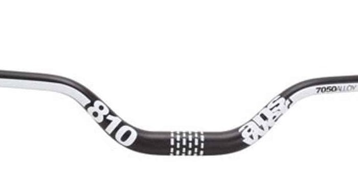

    Handlebars​
    The OEM handlebars are very flat mountain bike type bars. I wanted a more upright seating position as well as to not lean as far forward on descents. So I replaced them with the Answer ProTAPER 810 Handlebar 3″ Rise 31.8 Black.

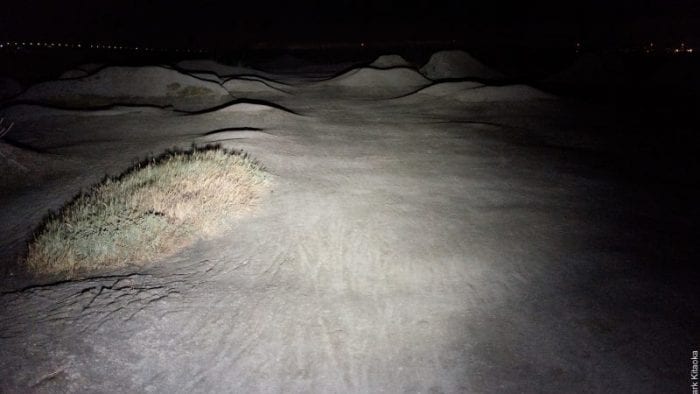

    Headlight​
    The Fisher Fab House headlight has several different levels (80 lumens and 750 lumens flashing not shown). Illumination on the street is VERY DIFFERENT than lighting needed out on a trail in total darkness.
    So the OEM headlight, although fine for the street and most venues was inefficient for where I ride at night. The OEM headlight does NOT have an on/off switch, it remains illuminated whenever the bike ignition is on. Same with the rear tail light.
    The examples below are at 50 yards from the FFH headlight. The light pattern width is approximately 10 yards.
    750 Lumens
    [​IMG]2900 Lumens
    3200 Lumens

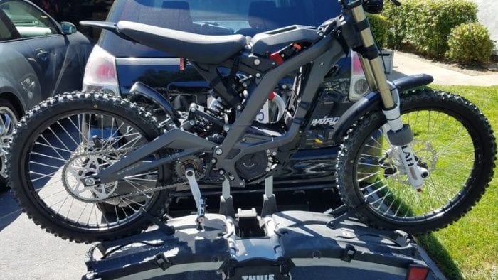

    How I Transport My Sur Ron​
    When I want to transport my bike the OHV parks or to take it with me I use my e-bike rack. Yep, no need for a truck or trailer!
    Yep the bike fits nicely on my Thule bicycle carrier.
