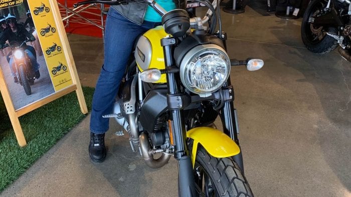

    As a first step, they had me come in and sit on a 2018 model equipped with the lower seat (a Ducati option) and all the pre-load backed out of the rear shock to increase sag.
    Creating a Measurement Baseline​
    I wore my riding boots which have a 1-inch sole, putting my inseam at 28.5 inches. These two simple changes were enough to get from tiptoes to the balls of my feet on both sides. Better, but still difficult for me to push the bike back or balance the bike in less than ideal terrain or conditions.
    It’s a little hard to tell but with the lowered seat I could just get the balls of my feet down
    Just backing out the preload isn’t the best way to lower a bike either as it can make the ride bouncy over rough terrain and we still needed at least another inch. Tim took measurements, both mine and the bike’s, and promised to get to work.

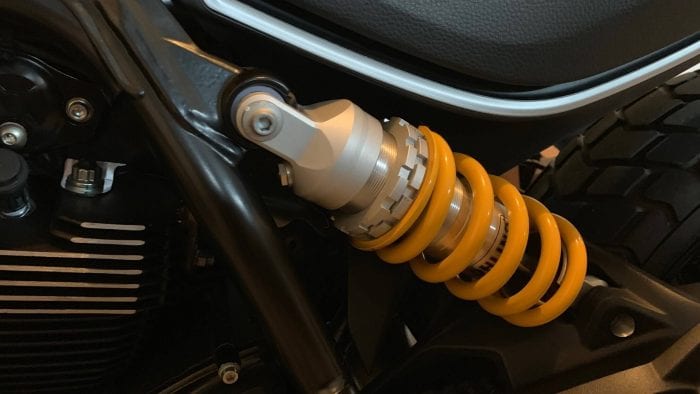

    Two weeks later I got a call from Ben, they’re suspension expert, that they were ready for another test. When I got there the bike was set up with an Öhlins DU-505 rear shock. A range of spring rates are available, but they used a light 110 N/mm spring.
    The Öhlins 505 shock is a single tube design with a large 46mm main piston and an internal gas reservoir within the main body of the shock. It is adjustable for both rebound damping and compression. Length is 296mm and stroke is 58.5mm.
    A close-up of the Öhlins shock on the bike
    For this test, they left the forks stock. After they weighed me with all my gear on, I sat on the bike and they checked the sag and adjusted the settings of the new rear shock to my specs. After also checking the sag and rebound of the forks, with me sitting on the bike, we decided the only thing that was necessary up front was heavier fork oil.

    The low seat option for the Scrambler is 20mm lower than the stock 2018 seat. After replacing the rear shock and adjusting it for my weight we were able to shave off another 20mm for a total of 2 inches.
    Ducati lowered seat & the Öhlins shock make a 2” difference
    My heels were still a breath away from touching down, less than a half inch, but I felt much more confident in my ability to control the bike.
